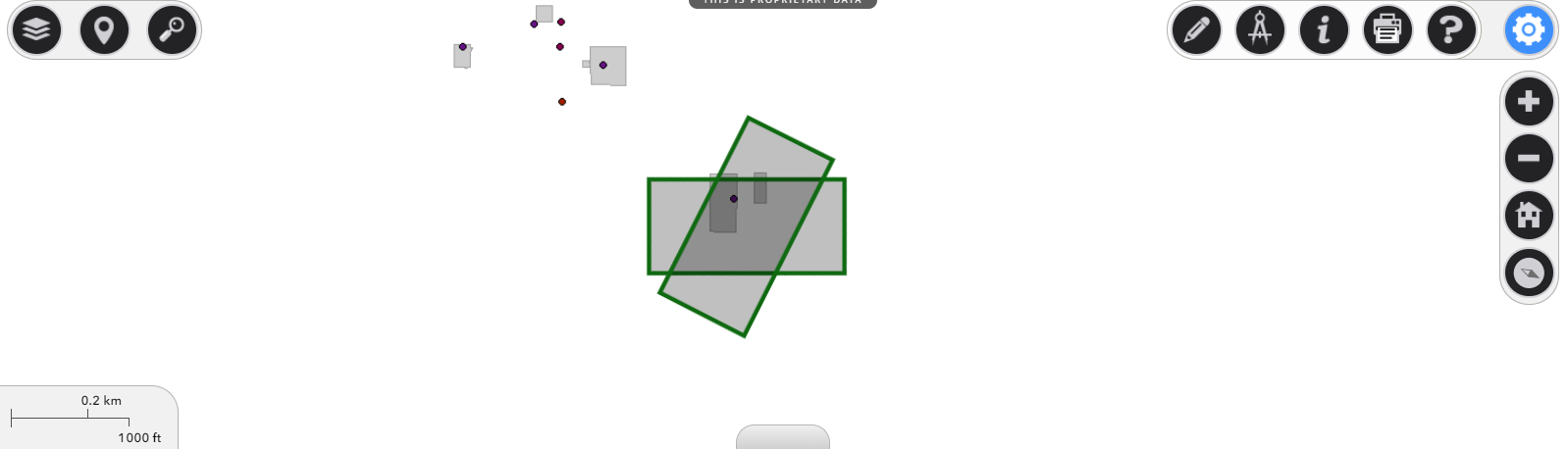

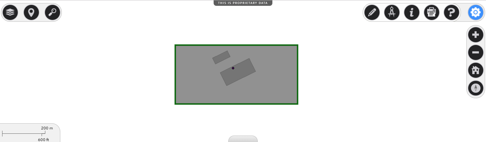

I learned something late last night that I thought some might find helpful. My client really liked the Attribute Table view widget I created for them, they just wanted one more thing. Filter by Extent. No problem I said at 4:00 pm, done that several times, 30 min tops. I code it up and all looks good until I notice that things on the screen are not on my list and things that are not on my screen are. 2 hours later I think to place a graphic on the screen where the bounding box is. And it was not at all where I thought it should be.
The images below are two polygons, the first is the bounding box of the Views.Extent, the second is a bounding box created by using the ScreenToMap util. The first image is with roation=0, the second is with roation=120.
Rotation = 0
Rotation = 120
