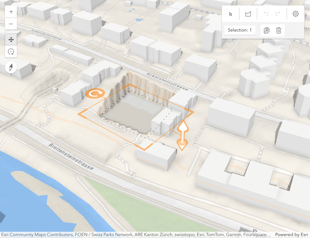

ArnoFiva
There are different approaches to achieving this. If you want to persist the altered elevation, it is best to publish the new elevation as a layer and add it as an additional elevation layer to your scene. This is something you can achieve for example with ArcGIS CityEngine: align the elevation to your buildings and publish it for a specific extent.
You can do some things also in the client using the ArcGIS Maps SDK for JavaScript. Using a base elevation layer you can change the height values that are returned by the elevation service. Here is a sample app that does this for arbitrary polygons, you can change the polygon using sketch tool: https://codepen.io/arnofiva/pen/YzoQNeq?editors=0010
Screenshot 2024-10-15 at 9.03.46 AM.pngScreenshot 2024-10-15 at 9.03.46 AM.png
