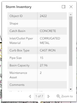

The popup remains at this height:
Is there a wrapper I am forgetting about?  I cannot seem to find the correct element.

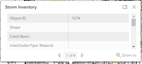

I actually figured out a solution.  I used the following .css within the index.htm file:
.esri-view-width-xlarge .esri-popup__main-container,
.esri-view-width-large .esri-popup__main-container,
.esri-view-width-medium .esri-popup__main-container
  max-height: 400px !important;
  max-width: 300px !important;
I had to do this since I was referencing the following .css:
<link rel="stylesheet" href="https://js.arcgis.com/4.11/esri/css/main.css">
I was trying to reference the code block above within my own layout.css...but could not overwrite the code specified in the link above.
The result is this:
