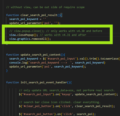

hoogw
 This is how I fix the problem. see picture.  with v4.31 in  2025
