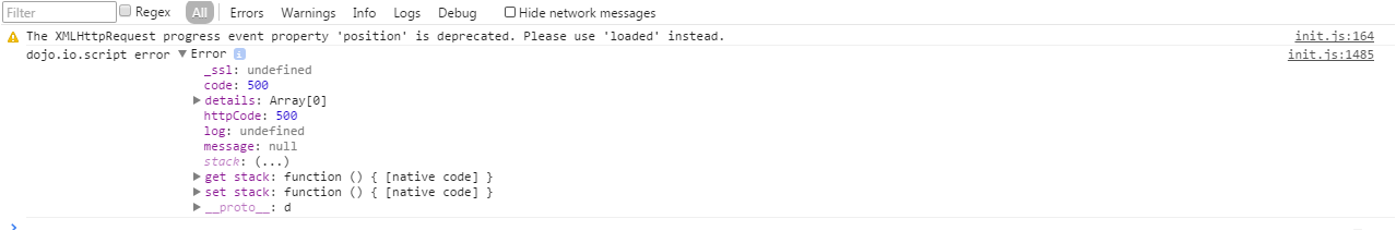

For some reason just in a last few days I am getting this error :
The XMLHttpRequest progress event property 'position' is deprecated. Please use 'loaded' instead.
init.js:1485 dojo.io.script error Error_ssl: undefinedcode: 500details: Array[0]httpCode: 500log: undefinedmessage: nullstack: (...)get stack: function () { [native code] }set stack: function () { [native code] }__proto__: d

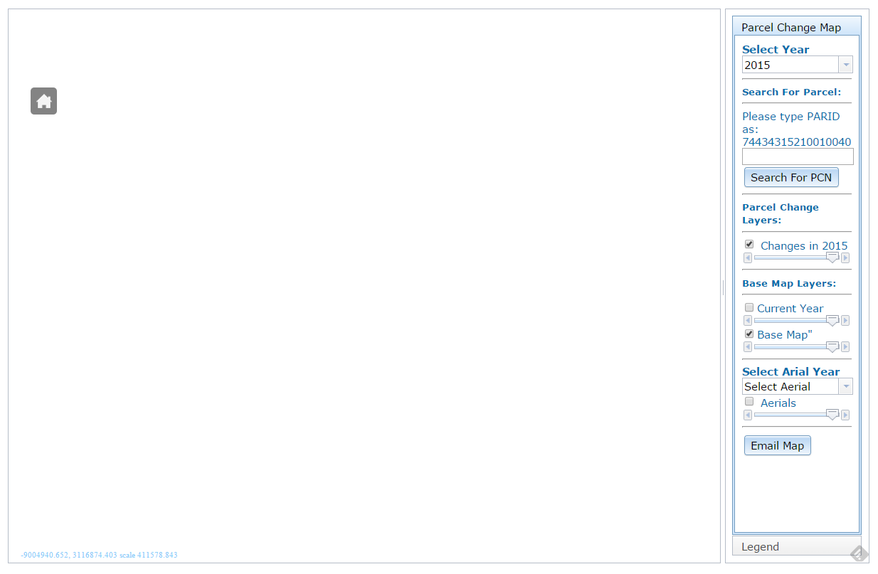

and this look:
The application used to work just fine and none changes has been  done. Is this error is on ESRI  side

The warning is actually coming from Chrome and pointing out where in the code it suggests a change be made.
You can see the warning in the console of Chrome DevTools on the samples pages.
ArcGIS API for JavaScript Sandbox
I think the warning is unrelated to the actual script error you are getting.

It looks like application loads fine. all javascript functionality loads, map div comes up but there is no data within the map.
i appreciate all your help
