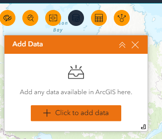

Hi folks,
I am hitting a brick wall and cannot for the likes of me find the functionality (native) to be able to add a "Add Data" widget like functionality to dynamically add feature layers to a map? Anyway have tips and/or a pointer to look at?

spence_amzn
DOH!!! Right in front of my darn face. Thank you so much.
