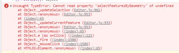

The app loads and the features display. The Editor widget does not. There are no errors in the console and, in fact, I know the Editor Widget does get created. When I do click on a feature, I finally get an error:
To me, this suggests that the editor widget does start and initialize but isn't finding any "editable" layers in the map (hence the undefined). But....how is this?

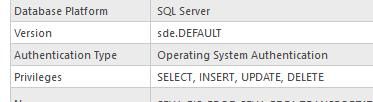

From inside of ArcGIS Pro, the source layer properties show that editing is allowed:

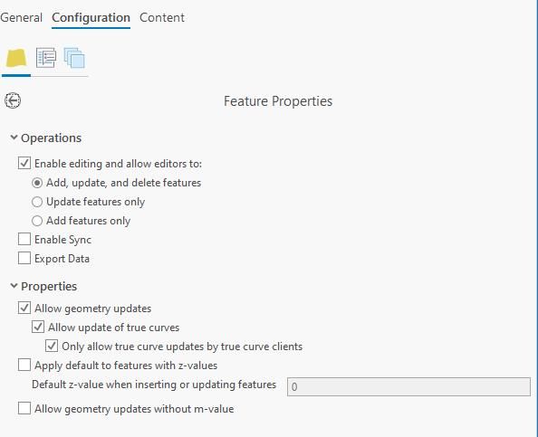

...from the publishing to Portal dialog, it shows that editing is allowed:
