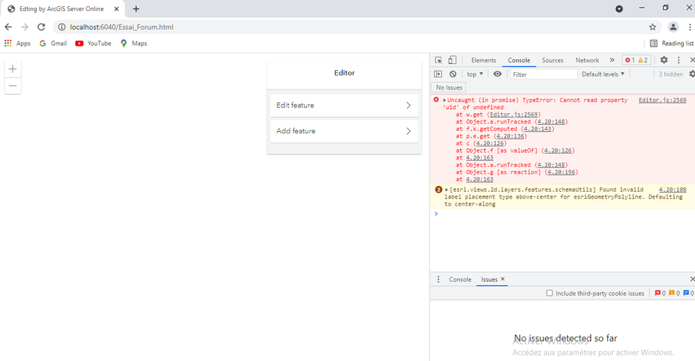

Please, could you guide me , I have a problem with the widget Editor (arcgis-JS-API),
I need to loop through all my featurelayers (in my map), to apply the Editor widget "esri/widgets/Editor", to the layers in my map (uploaded from Arcgis server online), because I need to add (edit, delete, update capibilities to my featurelayers in the same document) : could you please guide me, here you find my code, I have this error message, when I run it
The error message: (you find the screenshots, below, after the code)
Uncaught (in promise) TypeError: Cannot read property 'uid' of undefined
    at w.get (Editor.js:2569)
    at Object.a.runTracked ((index):148)
    at f.k.getComputed ((index):143)
    at p.e.get ((index):136)
    at c ((index):126)
    at Object.f [as valueOf] ((index):126)
    at (index):163
    at c.u [as _notify] ((index):196)
    at c.g.onCommitted ((index):198)
And here the code:

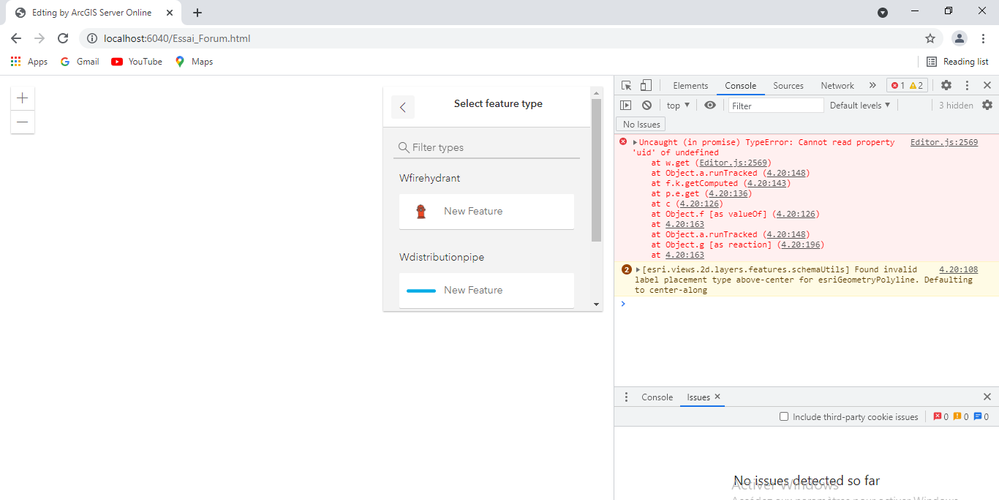

here the screenshots

HI
You don't need to loop trough the layers. The Editor-Widget itself checks the editable layers and add them to the widget. If you would like to do some fine-grained configuration you need to that on: https://developers.arcgis.com/javascript/latest/api-reference/esri-widgets-Editor.html#layerInfos
and even then you do not need to iterate because you define them separately and you can just use them.
To mention, your featurelayer are public accessible and everyone can edit them.
Working code-sample with your data:
