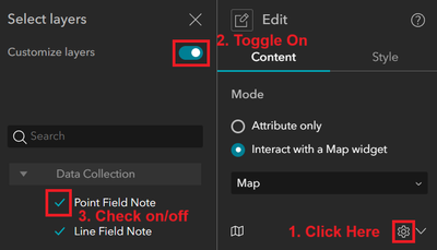

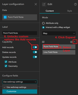

This last update broke the edit widget in all of my Experience Builder web apps.  The part of the widget that should allow you to do this (The customize Radio button) is what seems to be broken.
