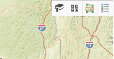

Hello,
I am working on a map that includes several Title Panes. I have replaced the Text in the title panes with images. Is it possible to create tool tips for the panes?
I have tried using the Dijit Tooltip class to display them, but it won't show when the title pane is created.
My code attempting to create the tooltips:
  //"BasemapTitle" is the Id for the TitlePane
            var myTooltipDialog = new Tooltip({
                connectId: ["BasemapTitle"],
                content: "Basemap Gallery",
                position: ["below"]
Thanks!
Chris
