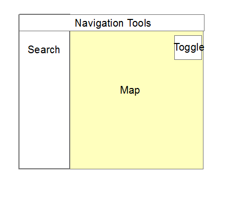

Hi Javascript Guru's,
As stated in a post a few days ago I am trying to learn javascript and i am pretty sure I am not understanding scope in terms of dojo. My goal is to create a layout that looks something like this.
I look at my code and it seems like it should create it but i am obviously missing something. All my javascript tools work if i don't add in a dojo layout and just use a standard div. It seems that what ever i am missing skips the whole tool bar and non map javascript and css.
Any help would be appreciated!

Matthew,
  You do not want to use parser.parse and dojo config parse on load together in your code.
I fixed some other code issues as well (like not using a dojo content container as the div that you are adding the search dijit to):

4 Replies
JeffJacobson
I have an example on Plunker that has a similar layout that you might want to use as a reference.
The first thing I would do is use your browser's debugging tools (F12 activates these in Chrome, Firefox, and IE) and see if any errors are occurring in your JavaScript code. It's possible an exception might be happening before the toolbar setup code happens.
Another thing to try (if you're not seeing an error in the browser's error console) is to use dojo/ready to ensure all of your Dojo components and DOM elements have loaded before doing anything else. (If you put all of your JavaScript at the bottom of the <body> element, you usually don't need to use dojo/ready, though.)
MatthewCieri
The only error i am seeing is:
TypeError: registry.byId(...) is undefined
http://localhost/test_js/queryLayer_w_template.html
Line 216
This is whats leading me to believe that it is scope related as its defined when i don't have the layout.
I will also take a look at your code.
Thanks,
Matt
RobertScheitlin__GISP
MVP Emeritus
Matthew,

MatthewCieri
Hi Robert,
Thanks again for looking into this for me. It worked perfectly.
Matt
