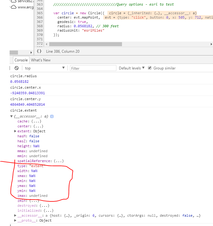

Does a Circle object have an extent in JSAPI 4.x?
1781
03-21-2018 04:56 PM
deleted-user-liuO8zXUrBPr
Deactivated User
    var circle = new Circle({
      center: evt.mapPoint,
      geodesic: true,
      radius: 0.0568182, // 300 feet
      radiusUnit: "esriMiles"
if you create a circle like this or any other fashion in JSAPI 4.6, It appears as if the circle object has an undefined extent unlike in JSAPI 3.x where circle.getExtent() would return a proper Extent type object.
Still new to 4.x. Happy to get advice on what i might be doing wrong. Any body else who can confirm - it is greatly appreciated.

Subu,
  The issue is your radiusUnits. You are are not using a proper value.
Possible Values: feet | kilometers | meters | miles | nautical-miles | yards
          geodesic: false,
          radiusUnit: "miles"

Thanks for the tip - Robert.
Carry over from 3.x. Worked fine there.
