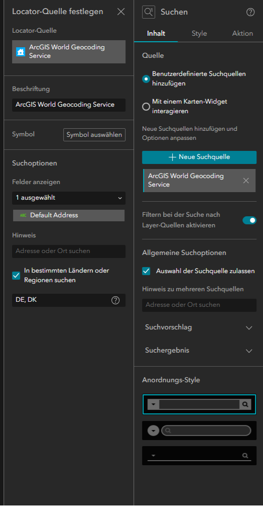

In the ExperienceBuilder its pretty easy to district on specific countries. It offers an option for that:
The LocatorSearchSource however only accepts a single country at once.
I hope there is an equivalent easy way to district the countries for the JS SearchWidget.

Hi @SebastianKrings ,
Using the countryCode property is the correct equivalent you are looking for. You should be able to add multiple countries by separating them by commas for your string input, similar to how you have done it in Experience Builder.
Here is an example: https://codepen.io/woriginales/pen/KwMOZPP
