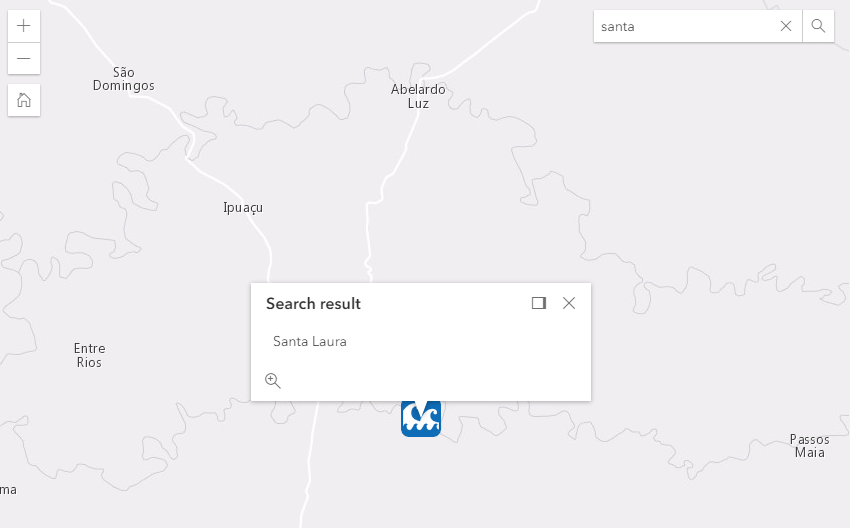

Hello.
So I am working with the 4.2 API and have a feature search feature in my current project. But I really do not need the automatic "search result" information pop-up to appear, the one that comes after i click on and zoom to my search results to appear (see below):
I however seem not to be able to find out how just to disable it, any suggestion?
I addition then how do I make the default pop-up for the respective layer appear instead of the dreaded "search result" window?
-Hlynur.

HlynurIngólfsson
Hey there Robert and thanks for this.
It is however not the popUp for the feature selected from the search that I am trying to disable, its the "search result" window itself. My code for the search tool looks like this:

But it still keeps on popping up even if I have all these false statements, any suggestions?

So here is my code.
Its basically referencing a simple featurelayer that is hosted on my ArcGIS online account, tits not the pop-up itself that is bothering me but the pop-up that appears after I have finished searching that shows up, that one I want to get rid of.

RobertScheitlin__GISP
MVP Emeritus
Hlynur,
  You had the popupEnabled property in the wrongs place:
      var searchWidget = new Search({
        view: view,
        allPlaceholder: "Unit name",
        sources: [{
          featureLayer: new FeatureLayer({
            url: "https://services1.arcgis.com/LpQVI6wAjYbHDKAK/arcgis/rest/services/Test/FeatureServer",
            popTemplate: {
              title: "{CATEGORY}: {NAME}",
              overwriteActions: true,
          searchFields: ["Name"],
          suggestionTemplate: "{NAME}, {OPERATION_}",
          excactMatch: false,
          outFields: ["*"],
          placeholder: "Type unit name",
          zoomScale: 200000,
          resultSymbol: false
        popupEnabled: false
Notice I do not have it inside the sources array but as a property on the search widget itself.
HlynurIngólfsson
You hit the hammer on the head there Robert! Appreciate it it, thanks.
