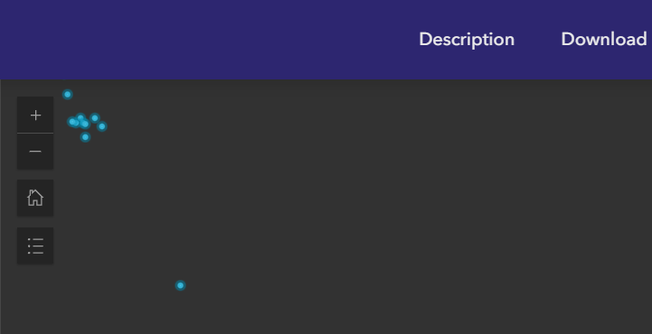

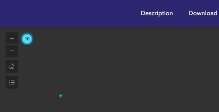

In this example below, we see there's a cluster of 10 features, and a standalone feature:
Here's what it looks like with clustering disabled:
Before running the test, I would expect one unclustered feature, and as many as 10 features that have been clustered. (I say "as many as" because some could be off-screen.)  However, running the test indicates 5 unclustered features, and 5 clustered features. Four of those features said to be unclustered are such because their shapes don't intersect the cluster graphic, and therefore are invisible, but returned by hitTest nonetheless.
This kind of workflow is the only way I can think of to determine if a feature is clustered or not.  But with hitTest implemented the way it is, the results here are unreliable.
