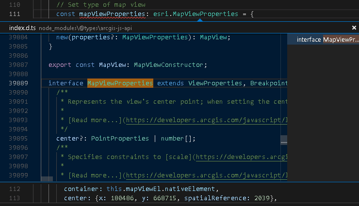

I discovered that when addressing the center property of the basemap, by default, it takes either an array of two numbers [x,y], or a PointProperties datatype... either way, SpatialReference is out of the picture and that is wrong.
The way I managed to solve this was by passing a json object as follow - { x:..., y:...., SpatialReference: 2039 }
This code luckily works, but I'm getting an error on the data type, since it's not documented as supported inside the API.
