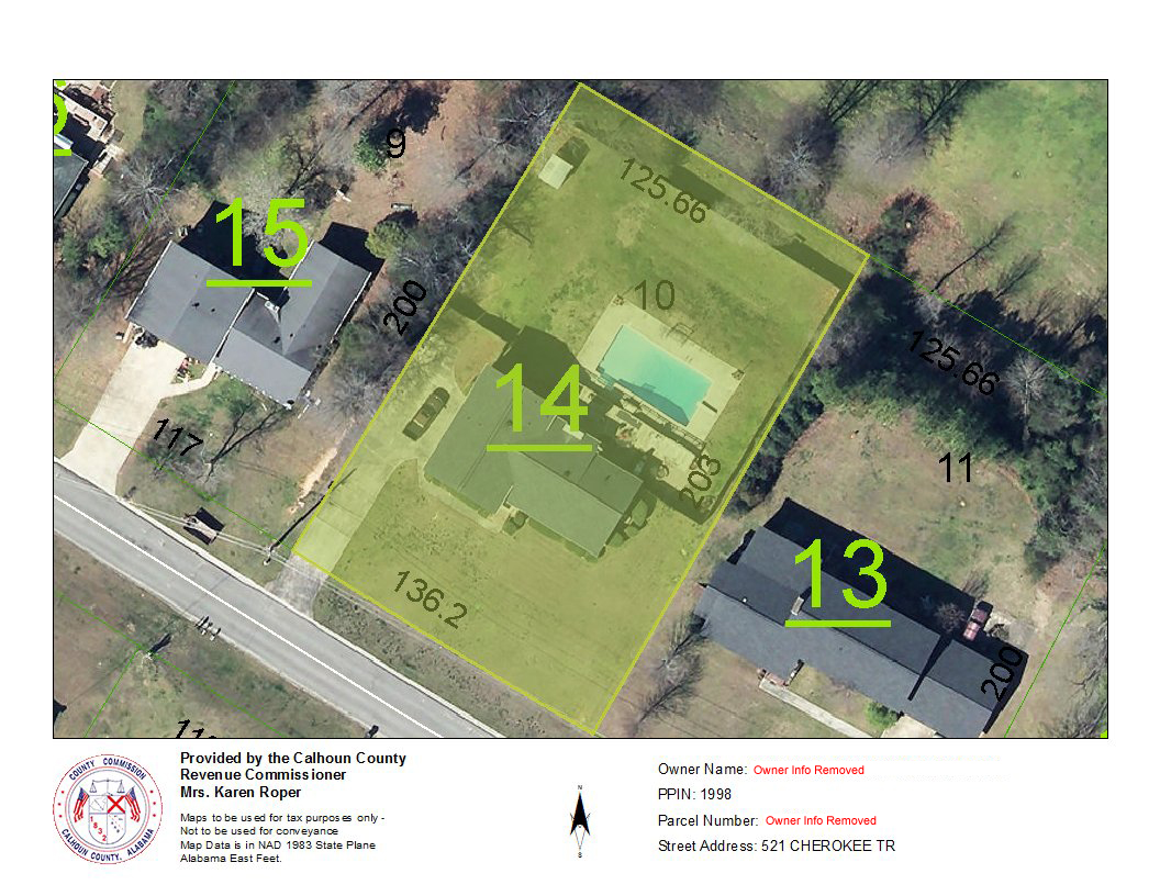

RobertScheitlin__GISP
MVP Emeritus
David,
  Sorry when you said
Is there any other way to manipulate the PrintTemplate to show customized text?
I thought you were just talking about adding so custom text element to the layout, not trying to control the text inside the legend element.
Creating a custom text element in the layout is absolutely possible with the use of your own print service that has a custom print layout defined. Like here (image attached) in my custom layout I add the Owner Name, PPIN, Parcel Number, Address to the layout based on the selected parcel Polygon:
