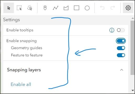

I'm trying to change the language of sketch widget into Arabic, how can I change the title used for each element and the labels of the graphics drawn.
thanks in advance.
