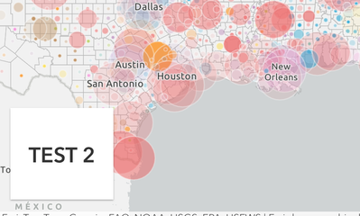

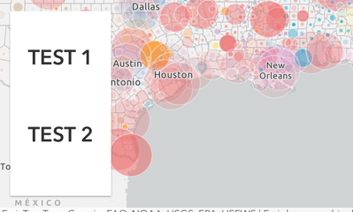

Hi Rene, here is a Codepen based on the sample for the Feature component.  https://codepen.io/justingreco/pen/LEYLRMd
I altered the defaultGraphic to show CustomContent displaying TEST 1 and then text content displaying TEST 2. With 4.32 TEST 1 doesn't appear but if you change it to 4.31 TEST 1 and TEST 2 appear.

4.32
4.31

Justin_Greco
I just tried it with the next version (4.34) and it is working.  Thanks for getting this fixed!
