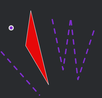

Edvinas_S
I created a new react app and copied this component. It works fine if you remove that useMapViewContext import.
I simplified your component and made it log every time a new graphic was drawn. If this doesn't work, it's possible you have errors in other parts of your code.
