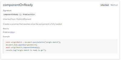

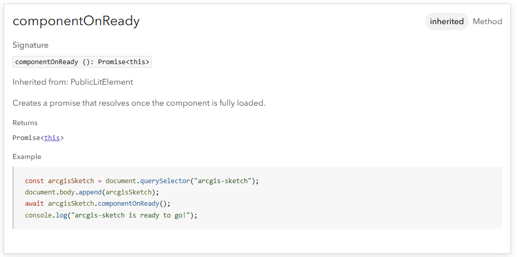

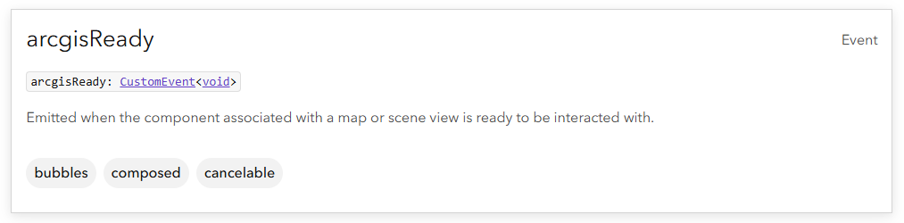

The problem we are facing is that we do not know how to properly await the time when the component truly finished rendering, meaning that also the shadowDOM finished rendering (for the first time or after changes). We tried awaiting the "componentOnReady" promise and reacting to the "arcgisReady" event, but both options do not work, as the shadowDOM does not seem to be fully rendered at this point. It does seem to exist, but is mostly empty, so that the elements we search for cannot be found yet.
Our current workaround is to use a MutationObserver to observe the shadowDOM and wait for the elements we need to appear within this shadowDOM. This is not a very elegant or efficient solution though.
Are there any alternative approaches? Or potential reasons why the shadowDOM is not fully loaded although the docs say that the component should be ready to be interacted with at that point:

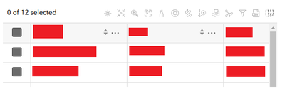

FeatureTable:
We are inserting custom actions into the action-bar above the feature-table. Also, we need a select-all button (because we only have small amounts of rows per table). This is the hardest adjustment for us currently, because the table is steadily loading and overwriting our manual ShadowDOM manipulations to hide the not-used select-all button (you already make invisble) and to add out custom select-all button. We currently have no solution for this, so this is a screenshot of our not yet migrated version using the FeatureTable widget (hiding our application data):
Do you maybe have any idea how to insert such a usable select-all button or is there even a functionality like this planned for the FeatureTable?

For the select-all button in Feature Table, we can see the use case especially for smaller layer types. We don't have any immediate plans to add this, but will look into it as well.

  • componentOnReady promise lets you know the component has been initialized and rendered once, fully loaded. This doesn't mean it's done loading though. A component like TimeSlider is still gathering info from the layers and map and could update again. It's useful to know when default values are assigned or when you can use methods on a component.
  • arcgisReady event lets you know that the component has a reference to the underlying view rendering the map. Meaning it can now communicate with the map. But again, it doesn't mean that the component is done working and could update its UI.

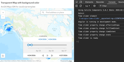

I tried the approach with listening to "arcgisPropertyChange" by editing your CodePen example to print the shadowDOM-part that we need for our manipulation and it seems to work:
https://codepen.io/insabelter/pen/yyadryp?editors=1000

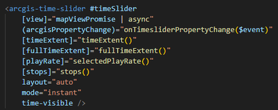

When trying to replicate this in our Angular 21 application, this event is not fired though:
The only printed event change after opening the component is for the "effectiveStops". There is no event being logged in our case for the state change to "ready". This might be due to the Angular lifecycle somehow interfering with the event because we bind the custom component properties directly to signals which are updated based on our configuration??
Do you maybe have any idea what might cause the component to not trigger the event for the state change to "ready"?
