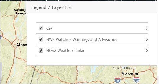

What shows in the Layer-list widget:
I am guessing that somewhere the "id" property is being overwritten. I am not sure where though.

ChristopherSchreiber
Thanks Robert,
I was using the "layers" array but I was not including the "Title" property. That is what I was missing.
