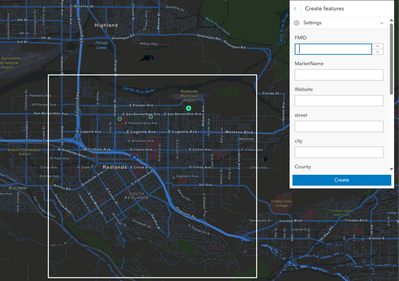

I'm using Editor widget for create features. Catch the "create" event and then validate wheter the feature is in the polygon or not. If it is not, set the invalid symbol and editor process pause.  If yes, then popup the attribute dialog.
The code not set invalid symbol sucessfully and how to set the edit process to pause state?
Code snippet:

The complete code is as below:
https://codepen.io/Baohua-Chu/pen/qEdwzvb
