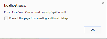

I am now getting the initials in a variable but at the end of the loop I get an error:
Here is my code:

Any idea?
by Anonymous User
Not applicable
This worked:
if (arraynew === null){
                console.log("Dont split");
                } else {
                var words = arraynew.split(' ');
                var text = '';
                $.each(words, function () {
                text +=  this.substring(0, 1);
                console.log(text);
                console.log(words);
