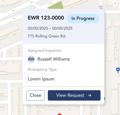

I am trying to create custom popup template content (Given below). I am using the Reactstrap frontend library for this development.
1) Is it possible to develop this type of custom template using ArcGIS SDK for Javascript? If yes How?

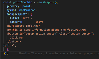

2) I already tried to develop this using pure HTML, But components like buttons are not showing correctly (Given below). What is the correct way to develop this?
Screenshot 2024-12-11 185055.pngScreenshot 2024-12-11 185055.pngScreenshot 2024-12-11 185029.pngScreenshot 2024-12-11 185029.png

This is a useful blog post that is still relevant for adding things like buttons to your popup.
https://www.esri.com/arcgis-blog/products/js-api-arcgis/mapping/using-html-with-popups-in-the-arcgis...
LakshanRasingolla
Indeed this is a good blog. I could customize my popup template to a certain level with this. Thanks @ReneRubalcava i
