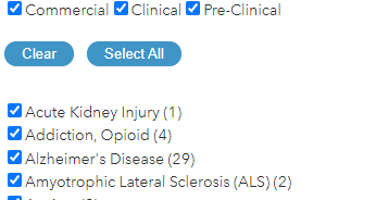

Thanks Daniel, that pretty much sums it up, (included a picture of the checkboxes I'm using to drive the filter) three categories across the top and 100 or so different indications.  When you check/uncheck one of the 3 boxes across the top I filter the sites shown using Layer.definitionExpression.   All this works well, but I'm trying to get a new count of how many sites perform that "Indication" to update the labels, for example: as you can see in the image there is 1 site that does "Acute Kidney Injury", if that site only happens to be "Pre-Clinical" and I deselect "Pre-Clinical" then after the filter runs I want to show (0) next to the label instead of (1)

As I said, normally I'd just query the database directly and build an array of these to easily change the values as checkboxes are changed, no way to do this in ArcGIS that I have found (I could definitely be missing something though)
