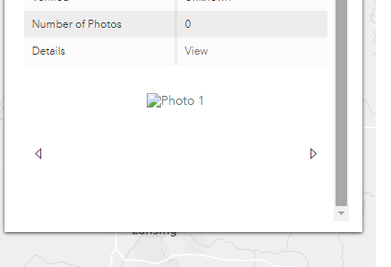

I am trying to figure out if there is a way to conditionally hide the mediainfos section of a popuptemplate?
The photos are external (not attachments) and I have a column called PHOTOS that will say 0, 1 or 2. Ideally I would like the mediainfos section not show if 0 appears in the PHOTOS attribute but so far nothing I have tried is working.
Does anyone have any insight into how this might be accomplished if it is even possible?
I'd like to avoid the broken image icon, like in the screenshot below so folks don't think that it's not working.

Hi there,
You can do this with the use of Function, Promise or with use of Arcade expressions. This SDK sample shows  how to change the popupTemplate's content dynamically depending on feature attributes. I have modified this sample just a little bit to show images depending on feature attributes. The main logic is in populationChange function.
Simple app: https://codepen.io/U_B_U/pen/dyVEWya?editors=1000
Hope this helps.

luckachi
@UndralBatsukh thank you so much for the visual - this was extremely helpful and with some tweaking I was able to accomplish what I needed! I appreciate the help
