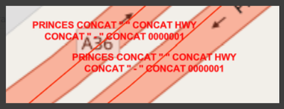

We published a map service using 10.6.1 ArcGIS for Server (on Linux) where the label is symbolised by concatenating 3 fields:
[Road_Name] + " " + [Road_Type] + " - " + [Road_Number]
When we use this as a Feature Layer in ArcGIS API for JavaScript version 4.18.1 (with npm build), the labels show up as the following:
That is, the word "concat" appears in the label, instead of "Prince Hwy - 0000001".

HenryKo2
Thanks Noah-Sager for the reply.
I should clarify, we published the map service in ArcGIS for Server with the following, using ArcMap:
Then we simply consume it as FeatureLayer in the JS app:
            this.layer = new FeatureLayer({
                url: ...,
                title: ...,
                popupEnabled: ...,
                visible: ...,
                popupTemplate: {...},
The result we got is the screenshot I posted above where "concat" happens.
We don't do anything explicit or special with the labels in JS code.
I would expect the labels to display correctly "out-of-box", regardless of SQL or Arcade expressions.
