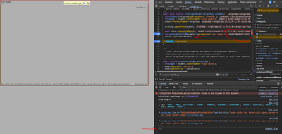

The image above shows the real time capture where I stopped the map rendering after execution waited for componentOnReady() to complete. As you can see, at this point, the component should have been loaded and I should be able to capture an element with the .esri-legend class name. But only null value returned in this case.

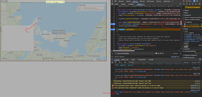

As you can see here, after componentOnReady() has finished executing, while there is no data as mentioned, the component DOM element of arcgis-print has been loaded into the map in this case.
