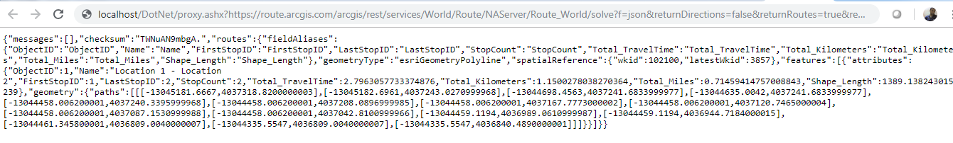

  I am trying to access the route service ,but while doing so I get the following error.
code":499,"message":"Token Required"
The localhost is being generated from Visual studio once I configured the Javascript SDK frok ESRI.
At the same time I just downloaded the routing example and with Dotnet proxy file I have hosted through IIS.
The routing is working for me.
Any possible reason why its behaving like this?
Below is the proxy used in IIS

Noah-Sager
Edit: The first example in the browser probably should have actually worked if the proxy was working correctly, because if I sign-in, I can see the service with the f=json
Original Post:
I'm not 100% sure what your question is. In the first example, it looks like you are trying to access the service REST endpoint directly in the browser, which should not work as I believe the services directory is locked down for security reasons. In the second example, you are looking at the results of the routing service request, which should work fine (and does).
ADITYAKUMAR1
Hi Noah,
   My concern is the nature of proxy/route services. At some point it works fine while when I go in other environment the same throws token error.
Noah-Sager
So the service works correctly through the Esri Resource Proxy? But what proxy is being used in the first example that does not work?
