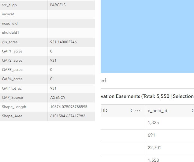

if both arcgis-feature-table and arcgis-features web components are open, they will be overlapped.
One way to address it is by CSS, to monitor if arcgis-features is open then you adjust the width of the table.
I am wondering if there is a another way to do it, or should it be an enhancement request?
Do you have a codepen for this? FeatureTable isn't really designed to be slotted into the map. Even the widget samples have it outside the map, so would be tricky to get it line up if you do.
The feature table is not slotted into the map. I realized that the issue was a css setting for the arcgis-features where I had position:absolute. All good now. Thank you.
