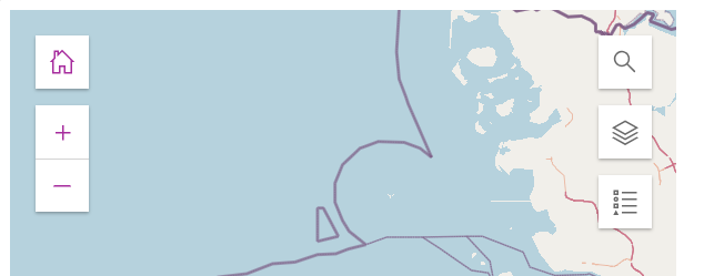

Good morning, I would like to customize the colors of the standard buttons on the map. However, only part of the buttons are being changed. Does anyone have an idea? Best regards, Alex

Hello, I think you need to add calcite-action to your list of styled elements
AlexWie
Thank you, that worked. However, it's unclear why the buttons need to be addressed differently. The actions only work for the expand button.
      calcite-list,
      calcite-button {
        --calcite-color-text-3: #7e0b6c; /* NORMAL */
        --calcite-color-text-1: #33012a; /* HOVER */
      calcite-action {
          --calcite-action-text-color: #9E007E;
          --calcite-action-text-color-pressed: #33012a;

Another question, same topic... I would like to change the color of the button, not the color of the text. It works for the PRESSED and HOVER states, but not for the normal state. Any ideas?
      calcite-button {
        --calcite-color-foreground-1: #9E007E; /* PRESSED */
        --calcite-color-foreground-2: #3d9e00; /* HOVER */
        --calcite-color-foreground-3: #f3c212; /* NOTHING ??? */
        --calcite-color-text-1: #fffdfd;
        --calcite-color-text-3: #212121;
AlexWie
I have the solution...
      .custom-home-widget .esri-widget--button {
        color: white !important;
        --calcite-color-foreground-3: #f3c212; /* NORMAL */
