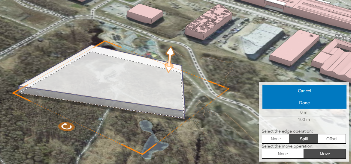

I have added a Slider widget to the following example inside the sketch panel. (https://developers.arcgis.com/javascript/latest/sample-code/sandbox/?sample=sketch-3d)
So it looks like this, however, I wish that the Slider would change the initial extrusion height based on the value set by the user.

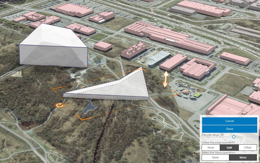

The provided solution works only for the first feature in the graphics layer. However, if I create another building, click on it, and try to change its extrusion, it would still modify the first building's extrusion. Is there any way to find out what feature is currently selected in order to change its extrusion?
Fore example, in the picture below, the selected building's height should be 58.
SaschaBrunnerCH
True, updated the codepen that it takes the last created graphic.
And there is definitely more room to improve when changing from creating to update and the other way around related to the values in the slider. But it shows the direction how this could get achieved.
