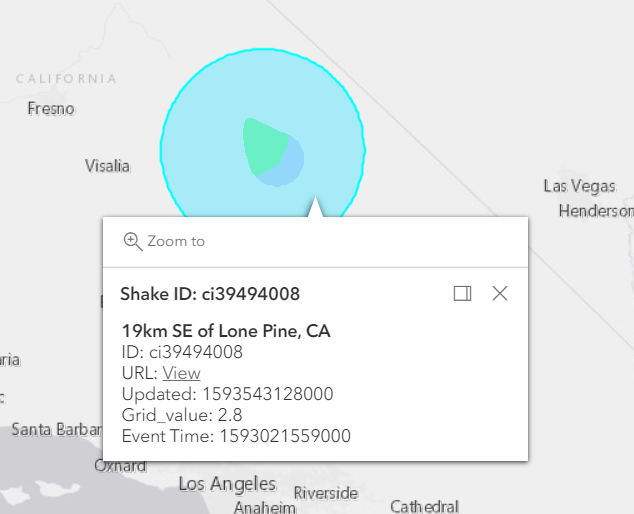

I have tried using the below in my initial query, and query right before drawing my polygons with class breaks.
        query.orderByFields = ["Shape__Area DESC"];
However this did not seem to do anything. I have also tried using grid_value field as well.
You can see in the screenshot a 3.8 grid value polygon overlapping making the inner 6.5 and 7.8 grid_value polygons in accessible to click.

CamCode
Thank you for the reply Ken, sadly it still does not seem to be working consistently with that in regards to the overlapping -- also, in the query right before I drew the polygons i stated all * out fields, so shouldn't that work the same? I don't think that was the issue.
CamCode
I am not sure the exact interpretation of how ASC or DESC are being used; but I would like the smallest polygons shapes to be added/drawn lastly so that their index remains on top of the larger ones and are clickable. Again, sometimes this occurs with some, but then some don't seems arbitrary -- just want to consistently be able to click all my smaller polygons. Should I explore a different method?
CamCode

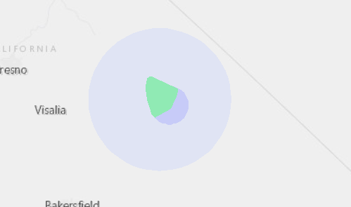

Here is a better screenshot: For instance, I try to click the green shape in the middle, the largest blue circle highlights and the popup only displays the meta for that one. Cannot click the smaller inner ones.
i.e. before click.
i.e. after trying to click the green inner small polygon -- only outer is accessible.

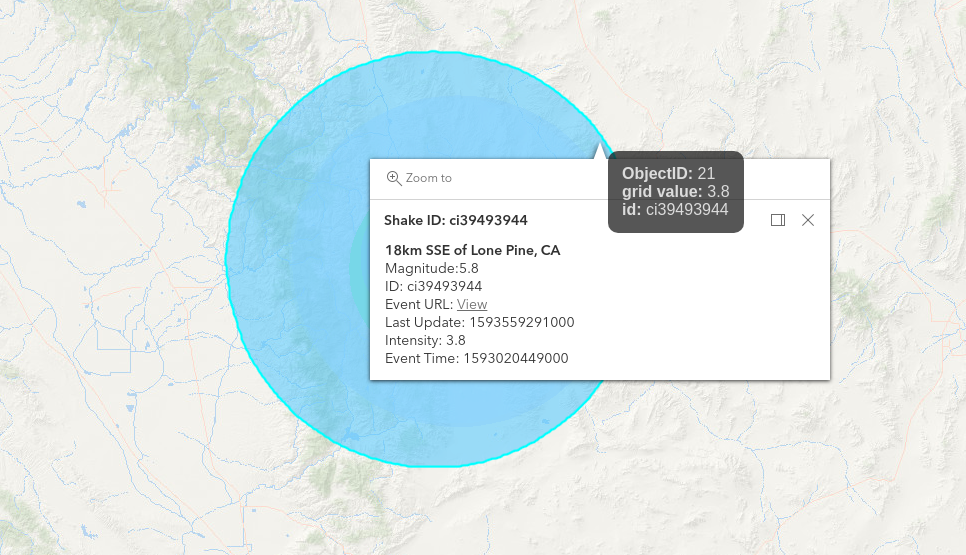

RobertScheitlin__GISP
MVP Emeritus
Cam,
   When I use the orderByFields:
      query.outFields = ["*"];
      query.returnDistinctValues = false;
      query.returnGeometry = true;
      QT.execute(query).then(function (evt) {
        evt.features.forEach(function (feature) {
          var att = feature.attributes
          var test = geometryEngine.convexHull(feature.geometry)
          var genpoly = null
          if (att.grid_value <= 4.0) {
            var rad = att.Shape__Length / 75
            genpoly = new Circle({
              center: test.centroid,
              radius: rad,
              radiusUnit: "meters"
          } else {
            genpoly = test
          var polygonGraphic = new Graphic({
            geometry: genpoly,
            attributes: att,
            type: "polygon"
          gras.push(polygonGraphic);
And select/check "us7000abmk" today I have no problem selecting each rings popup.....
CamCode
Thanks so much Robert, however, I just cannot get this to consistently work on all my shake maps. The order still seems to be rendered arbitrarily each time (each load), yes, some will render properly but some don't. Luckily I have noticed that if I add a border or outline to these nested or overlapped polygons, with all opacity slightly dropped, I can zoom in and click the outline/border to access their popups; though this is still not the most ideal. Perhaps the indexes is getting lost with the filter?
