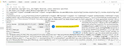

I am trying to host and manually modify the JS API 4.30 build in an offline environment on a windows server 2022 machine.

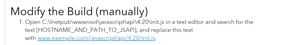

The steps mentioned here in the post shared below is helpful, but I am stuck at the manual modification of build step, where it says:
https://community.esri.com/t5/arcgis-javascript-maps-sdk-questions/how-to-hosted-locally-arcgis-js-a...

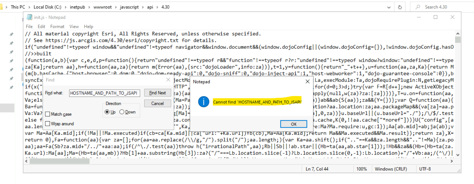

This path variable could not be found in JS API 4.30 init.js file.
Is there anything we are missing? Or is there any update with the steps for doing this with 4.30?

That step is no longer necessary because Dojo was removed beginning with version 4.20.  The download package comes with an install.html file that contains the steps necessary for setting the SDK up on your web server.
