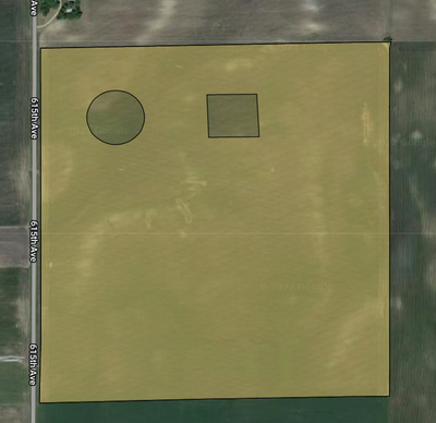

We need to draw a feature where a hollow could be created in some geometry . Is it possible with ESRI ?
DanielMiranda2
After you draw the initial polygon, save the edits. Then modify the shape with the "Continue Feature" tool. Draw your holes into the polygon, and then save the edits. This will create holes on the inside.
Here is some documentation on using continue feature, as well as other options depending on how your data is constructed: Cut a hole in a polygon feature—ArcGIS Pro | Documentation
