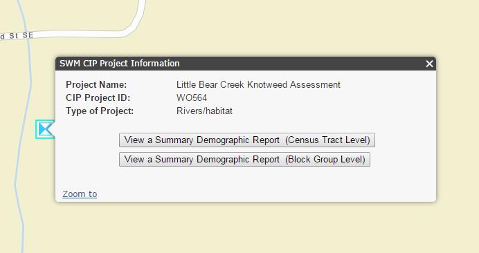

I would use a formatting function instead of trying to accomplish this in one JS line. Here's an example from one of my projects:
SetSwmPopupInfo: function(graphic) {
    var fullAttr = graphic.attributes;
    var rptParam, content, theProjID, theTipType;
    var theCipID = fullAttr.ProjectNo;
    var features = [];
    features.push(graphic);
    var fSet = new FeatureSet();
    fSet.features = features;
    app.curInfoGraphic = fSet;
    rptParam = "'" + graphic.attributes.OBJECTID + ',' + graphic.geometry.type + ',' + "SWM" + "'";
    rptProjectName = graphic.attributes.ProjTitle;
    if (theCipID.length > 1) {
        theProjID = fullAttr.ProjectNo;
    } else {
        theProjID = "Unknown";
    content = '<table width=\"100%\"><tr><td valign=\'top\' style=\"font-weight:bold;padding-left:3px;padding-right:3px\">Project Name:</td><td valign=\'top\' style=\"padding-left:3px;padding-right:3px\">' + fullAttr.ProjTitle + '</td></tr>';
    content = content + '<tr><td valign=\'top\' style=\"font-weight:bold;padding-left:3px;padding-right:3px;vertical-align:top\">CIP Project ID:</td><td valign=\'top\' style=\"padding-left:3px;padding-right:3px;vertical-align:top\">' + theProjID + '</td></tr>';
    content = content + '<tr><td valign=\'top\' style=\"font-weight:bold;padding-left:3px;padding-right:3px;vertical-align:top\">Type of Project:</td><td valign=\'top\' style=\"padding-left:3px;padding-right:3px;vertical-align:top\">' + fullAttr.Category.toProperCase() + '</td></tr>';
    content = content + '<tr><td colspan=\"2\"><br/><div style=\"margin:0 auto;display:table;line-height:28px;\"><button id=\"reportButton\" type=\"button\" onclick=\"app.trf.getTractProjectReport(' + rptParam + ')\">View a Summary Demographic Report  (Census Tract Level)</button><br\>';
    content = content + '<button id=\"reportBlockButton\" type=\"button\" onclick=\"app.brf.getBlockProjectReport(' + rptParam + ')\">View a Summary Demographic Report  (Block Group Level)</button></div></td></tr></table><br/>';
    return content;
Which looks like this once viewed in the application:
