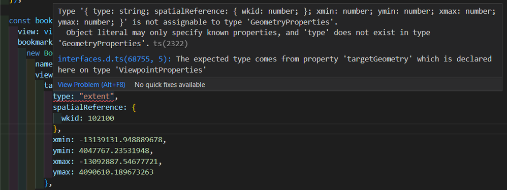

MohammedZaki
Hello @DimaY , did it work in Angular? adding a bookmark?
It gives me this error :
