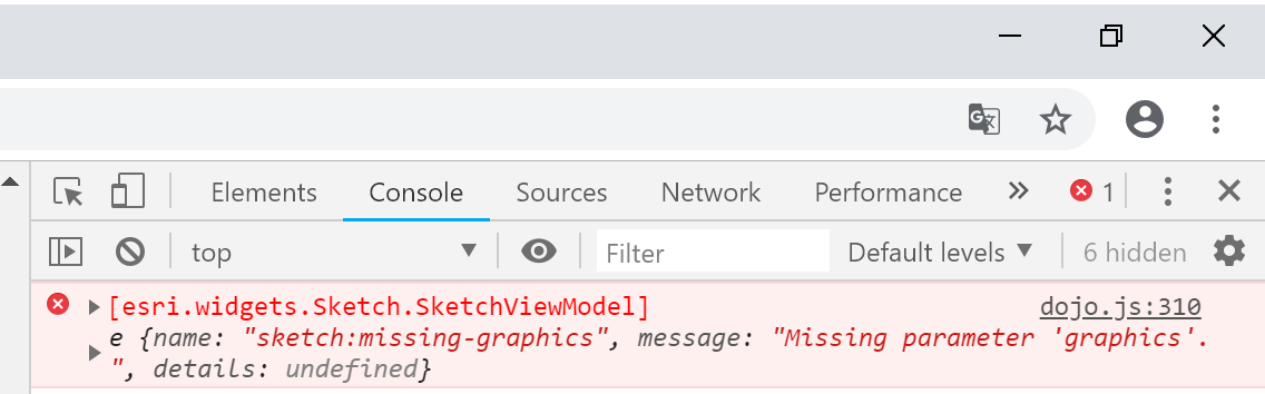

EssaddekMohammed
Hello, the error in the consol could be find in the image bellow;
In the line :
else if (!editGraphic && gra.layer.id === "tempGraphics") {
      isSearchGra = true;
      // Save a reference to the graphic we intend to update
      editGraphic = results[i].graphic;
      // Remove the graphic from the GraphicsLayer
      // Sketch will handle displaying the graphic while being updated
      graphicsLayer.remove(editGraphic);
      sketchViewModel.update(editGraphic);
      break;
in the line  : sketchViewModel.update(editGraphic);

EssaddekMohammed
Hello,
At the first call editGraphics's value is null,
The error comes after this line of code :
Regards.
