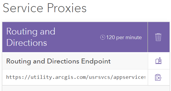

Thank you for the response. After some downtime i'm back to figuring out this task. To better understand the process of setting up the proxy i'm now trying to follow the routing and directions example. (Directions widget | ArcGIS API for JavaScript 4.6 )
If set up an file on an IIS server. Now im not sure which app id and secret i have to use. Building an application in arc gis for developers returns me a clientId and a clientSecret. Adding a service proxy there gives me the link in the picture below. Im afraid thats not the service the widget uses. So my question is what client secret and id to use? Or should i somehow change the service used by the widget? Code below.
Best regards
Config file:
<?xml version="1.0" encoding="utf-8" ?>
<ProxyConfig allowedReferers="*"
 mustMatch="false">
 <serverUrls>
 <serverUrl url="http://services.arcgisonline.com"
 matchAll="true"/>
 <serverUrl url="route.arcgis.com"
 clientId="***"
 clientSecret="***"
 matchAll="true"/>
 </serverUrls>
</ProxyConfig>‍‍‍‍‍‍‍‍‍‍‍‍‍‍‍‍‍‍‍‍‍‍‍‍‍‍‍‍‍‍‍‍‍‍‍‍‍‍‍

MichaelLodes2
Got it working now. I'm not to sure what the problem was, but it was in the proxy.config file. Using the code below made it work.
Config file:
 mustMatch="false">
 <serverUrls>
 <serverUrl url="https://route.arcgis.com/arcgis/rest/services/World/Route/NAServer/Route_World"
 clientId="***"
 clientSecret="***"
 matchAll="true"/>
 </serverUrls>
</ProxyConfig>
So i removed:
matchAll="true"/>
And changed the url to "https://route.arcgis.com/arcgis/rest/services/World/Route/NAServer/Route_World ". I'm sure though that i tried this url before. Anyway it's working now and this thead can be closed. Thanks for the help.
