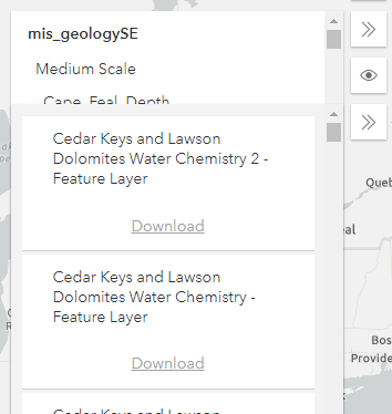

I am looking for a way to add some script to my current application that will make widgets close when another widget is opened. The issue I am trying to avoid is having multiple widgets overlapping each other like this:

The Expand widget has a group property that will handle this for you.
https://developers.arcgis.com/javascript/latest/api-reference/esri-widgets-Expand.html#group
