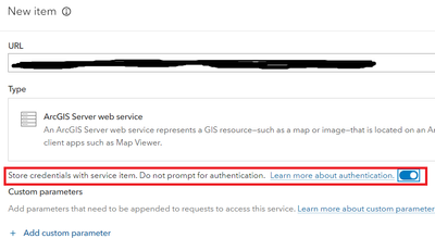

SailiTang1
Hi,
Did you try this? Adding the service to ArcGIS online and turning on "Store Credentials with service item. Do not prompt for authentication." And then, share the item you added to public.
MirHashmi
Hi @SailiTang1  Thanks for your reply. However, I do not have an ArcGIS online option available. The service is available on premises arcgis portal. Thanks.
