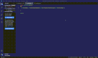

Also, if you like using the esri-loader, I built a cool VS Code Plugin that auto completes the loadModules() function (also supports TypeScript):
