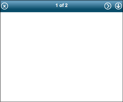

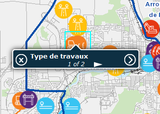

Hi,
I would like to know if it's possible to show the infoWindow directly fullscreen after a touch event on mobile instead of showing a small popup in which you have to click again to display the info fullscreen.
I would like to prevent this popup above and automatically show the fullscreen InfoWindow like below.
It's for a 2D WAB application in version 2.13 so the ArcGIS Javascript API version is 3.29.
Any suggestion?
Thank you!
