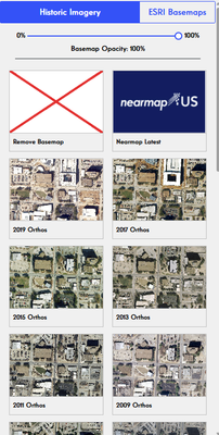

There's nothing stopping you from using more than one basemap gallery. I've built an Experience Builder Widget on top of the arcgis-basemap-gallery component that has a tabbed presentation allowing the end user to switch between two categories of basemap.

fdeters
Yep, this is what I'm going for in the meantime. Would still love a supported way to organize the presentation of the basemaps, though.
