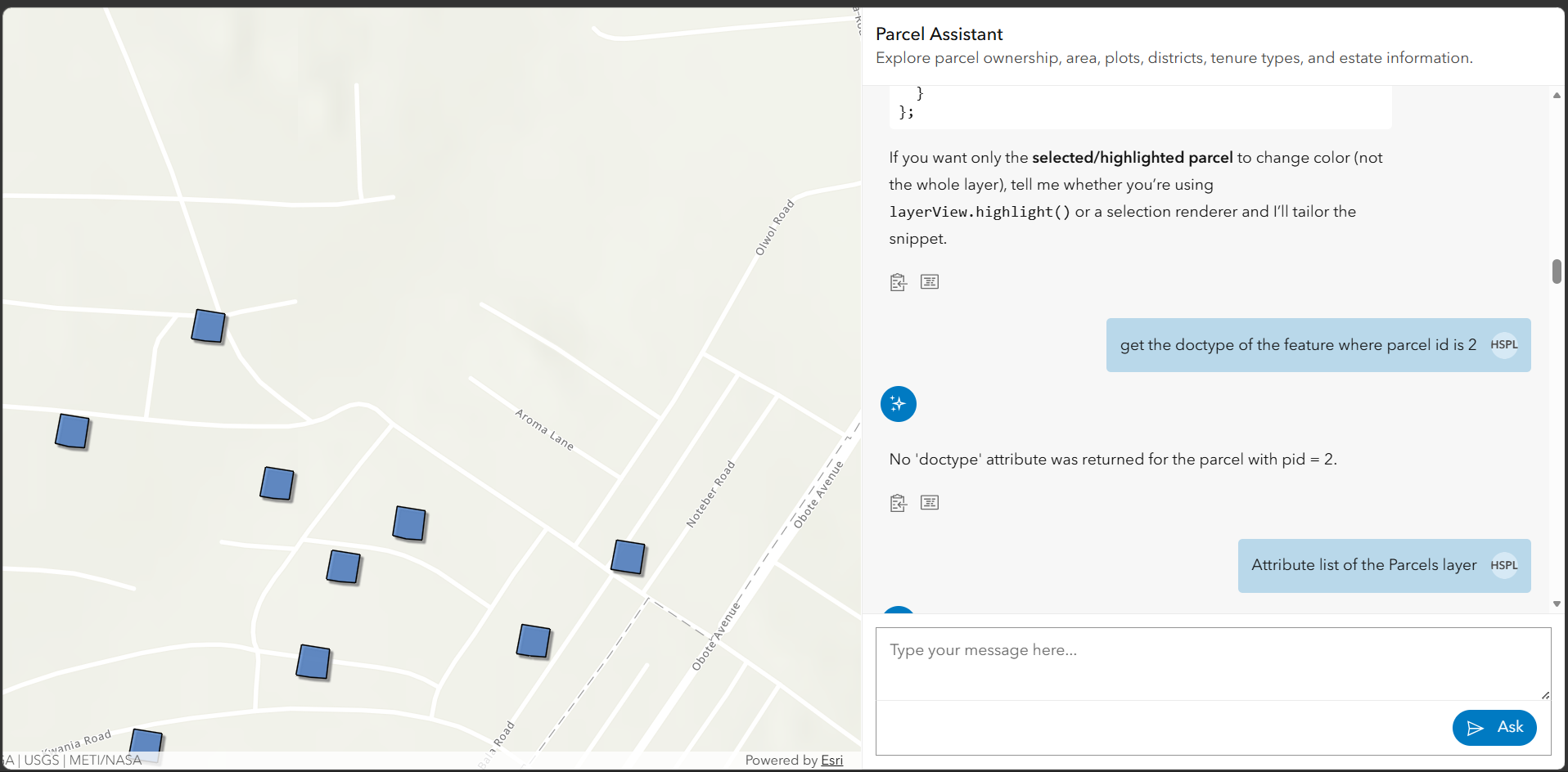

Query related table
* Prompt: `Get the doctype of the feature where parcel id is 2.`
* Result: Not working.

Main issue
The AI assistant correctly answers questions based on the parcel layer attributes, but it cannot retrieve values from related tables such as `documents`, `owner_table`, `tax_assessment`, and `agreement_status`.
