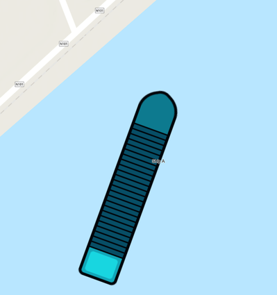

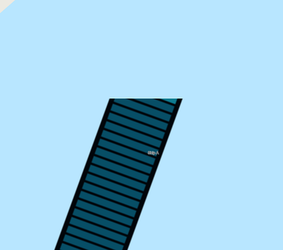

Found a bug using CIMPictureMarkers with xScale overrides and visualVariables.
Made a codepen:
https://codepen.io/michaelk95/pen/NPRwbba?editors=1010
To reproduce:
Zoom to level 20. You'll see clipped images. (It's only at level 20+)
Level 20:
Level 19:
Thanks in advance!
Gr
Michael
AnneFitz
Hi Michael -- Unfortunately this is currently a known limitation with symbols and real world size visual variables. When the symbols start to take up the majority of the visible map (spanning multiple tiles under the hood), they can get cut off. We are investigating ways to fix this issue in the future, but it's currently a limitation.
