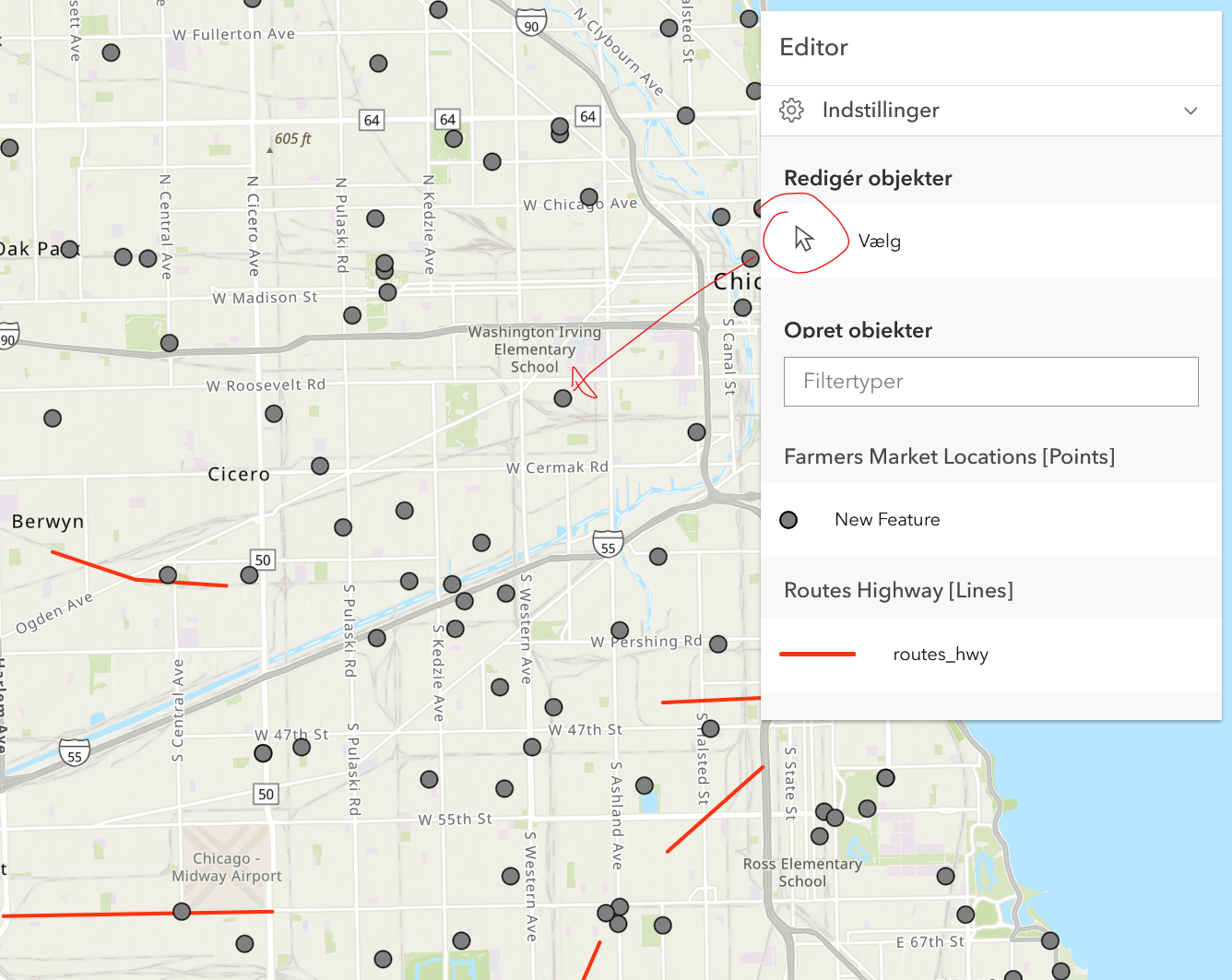

ThomasRohleder
Thanks a lot for the great explanation and solution — super helpful!
I’m still having trouble figuring out how to tap into the event triggered when a feature is selected on the map via the Editor.
Any ideas on how to do that?
