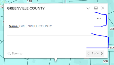

We are exploring the 4.25 update for the new .addHandles feature but are running into an unwanted change with the popups.
A header and footer are being inserted above and below the content and are buried deep in #shadow-root.  The color of the content div has also changed to a lighter gray.  I have tried using the visibleElements settings to no avail.  I am hoping that there is a setting or property that I can edit to prevent these divs.
The only change to the codebase is the new API version. The header and footer can be seen in 4.25Popup image vs. 4.24Popup image.  The location of the offending divs can be seen in the headerInShadowroot image and the visibleElements values in the visibleElements image.

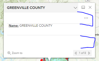

I'm getting this same issue as well:
I'm not sure if I can make a codepen sample but my setup is pretty straightforward. The popups are set up in the map in Portal.

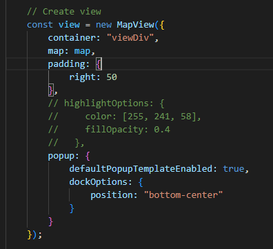

In the code I just have this:
I haven't changed anything else in my code/the map other than switching to 4.25.

JustinKirtz1
@LaurenBoyd
Yes, it is configured in Enterprise. We are in 10.9.1. Yes, I'm referencing the 4.25 stylesheet.
I'm getting the same issue in our map deployed in ArcGIS online as well. My development environment points to a map in ArcGIS Online, our production app points to a map in Enterprise version 10.9.1. Both of them have this issue:
ArcGIS Online Map:
ArcEnterprise:
