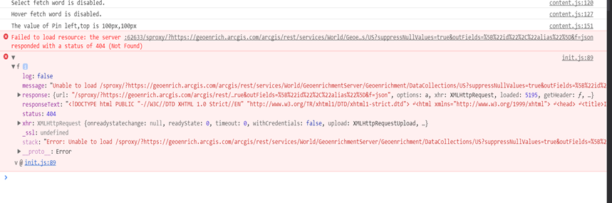

I tried to run the following sample code link on my own computer for Geoenrichment - InfographicsCarouselArcGIS API for JavaScript Sandbox
I copied all the codes and try to run it, but always get the following error:
I do have AGO online account. Is this about proxyUrl setting? Thanks!
KenBuja
MVP Esteemed Contributor
Take a look at the proxy page in the help for information about how to set one up.
